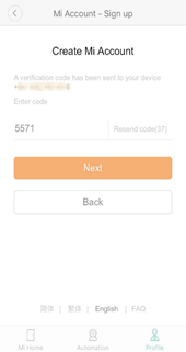

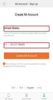

2. Register for a Mi Home account using your phone number (Skip this step if you already have a Mi account).
input your phone numberinput verification codeclick on Submit3. Add Roborock Device

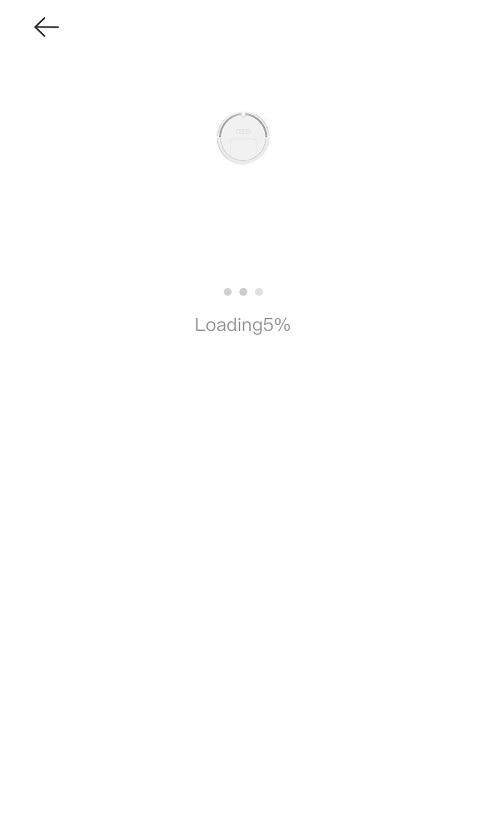

4. Tap the device in the Mi Home homepage to Access device to operate and wait until initializing reaches 100%.
